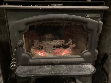

I've been trying a new approach this past week:
-burning 50% biobricks and pressed logs, and 50% reg firewood.
-loading the stove up before leaving for the night. (not my favorite thing to do in an unmonitored space, but this is an experiment.)
If I return in the morning to a space above 30 degrees, it's pretty quick to get up above 50 degrees- thus my working life is improved.
Yesterday (blizzard day) I worked in the space all day, feeding the fire every hour*, and could only get it to 57 degrees.
At 4:30pm I left a full firebox going and air flow tamped.
Returned at 8:30pm to 43 degrees, i.e. a loss of 14 degrees while the fire was going.
As a point of comparison, I left our home for the same exact same period of time and only lost 6 degrees.
(900 square feet, starting temp 67, ending temp 61, Esse Ironheart, fed and tamped prior to leaving)
*The Lopi Answer fire has to be fed every hour to maintain temperature- the firebox is small and all material will be ash in 2 hours once the fire is going (doesn't matter whether it is wood or biobricks or pressed logs).
The small firebox proves to be more of an issue with bio bricks and other pressed sawdust things. Material falls out of this firebox A LOT and dealing with chunks of hot wood coal is better than dealing with sprays of flaming sawdust.
I would be curious if anyone else is using this specific stove as a sole heat source, in a cold climate, in a building used only during the day.
Based on my current experience, I think Lopi Answer would have to be fed at night a few times to maintain an acceptable temp level (i.e above 50.)

Hi Rose Lane, if you are adding wood to the stove every hour, you are not burning the stove the way it was designed to be burned. I'll add wood to my Lopi Answer three times a day in the depths of winter and twice per day on a 40 degree day. My house is 1250 square feet in an 8000 heating degree day climate. It will not heat the house by itself below 30 degrees F, and if I skipped a load, the house would cool down a lot (without supplemental heat).
Having said all that, your cottage should be able to get warmer. If your wood was wet, you would have to expend a lot of heat energy to keep the stove temps up. A comparison - I loaded my stove on coals at 200 degree stovetop temperature with a full load of wood at 6:30pm - it was a mix of half hickory and half sugar maple. By full load I mean that I had the firebox probably 80-85% filled using a bunch of square split pieces that I could stack in very well. By 7pm the stovetop temperature was 500 degrees. It will be between 500 and 550 degrees from 7-10pm before the temperature starts to decline due to the wood being mostly coals.
If your cabin is poorly insulated and/or you are starting from a 30 degree temperature in the morning, you are probably asking for this size stove to do too much. However, once you gain experience running the stove, leaving it unattended overnight to heat the cabin should not be a concern.
Just by your description of how your stove is burning, I think you are having to give the stove a lot of air to overcome the moisture in the wood. A load of all bio bricks should burn well, and you should be able to turn the primary air down nearly all the way to get great heat and sustained burns with off gassing.
There is a learning curve with a new stove. I would stick with it and figure it out. You'll have the same burning problems with a larger stove too if you don't learn the right techniques and get the right moisture content wood in the firebox.
