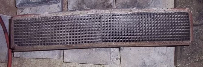

Matt, you sent up a red flag when you said greyish whitish? Can you post a picture. This is often the sign of overfiring.

here is a pic of the catalytic unit.

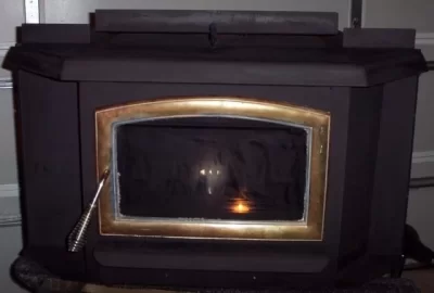

here is the stove itself, in the process of removing rust, and curing paint in the garage, since its 38 degrees and raining outside.

So the greyish-whiteish reference is about the catalytic combuster and not the stove? The stove looks nice now. Is the picture after the paint job?
yes, the gray white was in reference to the cat unit, you had me scared!
I had read that was normal for them.
Ill do the vinger soak on it, if i can figure out how to replace the fiber packing around it.
Yes, I sanded, wire brushed and painted the stove, it had a few spots of surface rust.
I used rustoleum high heat.
I have used it before with good results ( on my wood bbq cooker)
and it seems OK, for this purpose, im more concerned with being warm, than impressing the wife's asthetic sensability.
the door, appears to be a solid brass casting.
Id prefer black or silver, could I paint it?
or would that be blasphemy?
thanks for you help BeGreen!
Sorry about that, it's late and I wasn't reading carefully. The stove looks great as it is, I'd leave it original. Paint will just scratch anyway.
It was designed to run with the cat, so it's worth trying to get it working well. There is a strong possibility that the cat has been replaced once or twice already. The combs look in fair shape so I say try it out. Vacuum out the cat chamber well and give her a try once the liner is in. Keep us posted.
