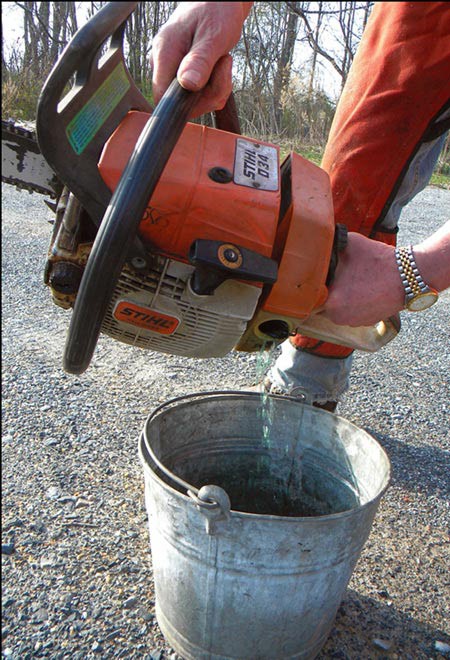

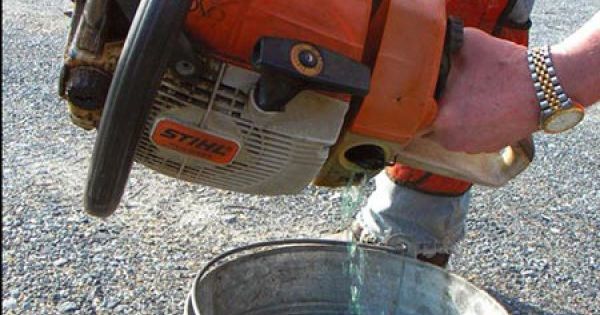

A relevant article for hearth.com
One thing to point out from that article...as far as "run 'er dry vs leave the fuel in there"...a plastic tank is fine stored empty, any machine with a steel fuel tank will rust if stored empty...unless you live in the desert or something.
