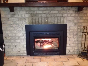

BIG QUESTION- should the bottom of the stove be caulked or contain a trim piece since I think this is where my ash is coming from (see my last post in this thread). Not using he blower ever again is not an option......

I can see how this could be happening if the blower was left on during cleaning. If this is the new insert it looks like it has a fairly shallow firebox and no ashlip. That looks like it would make neat cleaning a bit more of a challenge.

Do you have the universal or cypress front?
I don't know why you should have agap at the bottom on the install. The cypress looks like it almost sits on l"legs" at the edge, but the universal looks like it is flush with the floor. I cannot imagine the insert being designed with a gap at the bottom that is 1/8 inch. How could you ever clean under it? Just a huge problem. Also don't understand whi ash and coals are coming out. Are they falling out through a gap, are they falling out when you clean the stove or reload? I'd speak with the manufacturer. Unless they have designed a gap underneath for air cooling or some such thing, I'd surely seal any gap so I could clean the hearth without ash getting pushed under there. Where does the blower blow? If it blows air out under the stove, then you obviously cannot seal a gap down there. Or if the stove pulls room air in through a gap. But, again, I'd ask, because I think you are always gpoing to have a problem if ash regularly spills out of your stove.

3.we have the metropolitan face which has little x's across top and bottom for ack of a better description.

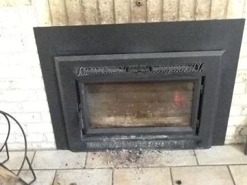

6. The 1/8 inch gap gets ash under it. See picture. This is right after I carefully loaded it. That is what spilled out. So after every load, we shovel what you see into the ash can(and take outside) or back into fireplace. THIS is where I think some is crawling under the unit due to the gap. As you can see from picture, the front of he unit is filthy. That is why we ave to clean it every few days. The blower is blowing out ash, so it is getting into the lower somehow.
So, my question stands....could the ash falling out (and our cleanup of it) be getting it into the blower and spewing all ore my house? (See pictures on the start of this thread). If so, that bottom should be caulked, no?????
Sorry about the upside down picture- will try to repost. Darned iPad.

Yes, the issue here is a shallow firebox front lip and no ash lip on the insert. The ash on the hearth is getting sucked up into the blower which intakes air front and bottom center. With this stove I would consider perhaps having an ashtray fabricated and attaching it to the front of the stove just below the door opening.
For now, take the vacuum and clean out the front grille and hearth. You will need to do a thorough cleaning of the blowers and air duct channels too as soon as you can stop the stove for a day. (pages 26 and 28 of the manual) After an ash lip is installed this should become less of an issue.

Everything IS installed correctly. The duo from the fireplace store (installer and owner) came out and spent almost two hours looking, talking, photographing and eventually moving out the fireplace. I was correct on the slight gap at the bottom - ask that climbs over the lip (on almost every burn) falls to the floor. When we sweep up, some goes under the fireplace. When they removed the faceplate, there was a three inch pile of ash immediately behind the faceplate (so not under the unit). This showed me that 1. Husband has NOT been as careful as me when cleaning ash spills (pushes shovel toward unit to scoop up, in effect pushing ash UNDER the unit) 2. We need to not overload fireplace so that ash spillage out front is minimized 3. Ideally, we would elevate the unit 4 inches (yes, there is room in our actual fireplace area, but it means pulling the liner up as well and bricking the bottom for aesthetics). This would mean that ash spillage would have a lessened chance of sneaking UNDER the unit. 4. We can consider getting a tray fabricated for in front of the unit when we open door to catch spillage 5. We need to continue to scoop half of the ash out every 2-3 days so our wood is laying in the box and not on top of the ash pile, lessening the chance that it may fall forward (and out the door when opened)
The guys vacuumed out the entire surrounding area to the unit. They showed me how to remove the faceplate if this shoudl become an issue again. They showed me under the unit (and the lack of ash in that area).
I am VERY happy - burned since they left and....my mantel is CLEAN FOR THE FIRST TIME IN 4 MONTHS!
So, next question......Where can I have a tray fabricated in case my hubby continues to be a pig when he loads firewood?

Glad you've discovered the issue. Not surprising. Insert + Blower requires cleanliness. Any sheet metal shop can fix you an ash pan for next to nothing cost wise. Pick up a can of stove brite paint and match the color and you're all set. Couldn't probably even make one yourself if you got a sheet metal break (maybe rent one?)

You should be able to have any decent sheet metal shop bend you up a simple ash lip. I would have them make a 1" L bend downward for the back side and 3/8" L bend upward on the front edge. I would also ask them to radius the corners to eliminate sharp corners. 20ga steel would work. It will need to be drilled for attachment holes unless just held in place with magnets. And it would need to be cleaned and painted for a more presentable look. You can remove it at the end of the season.
