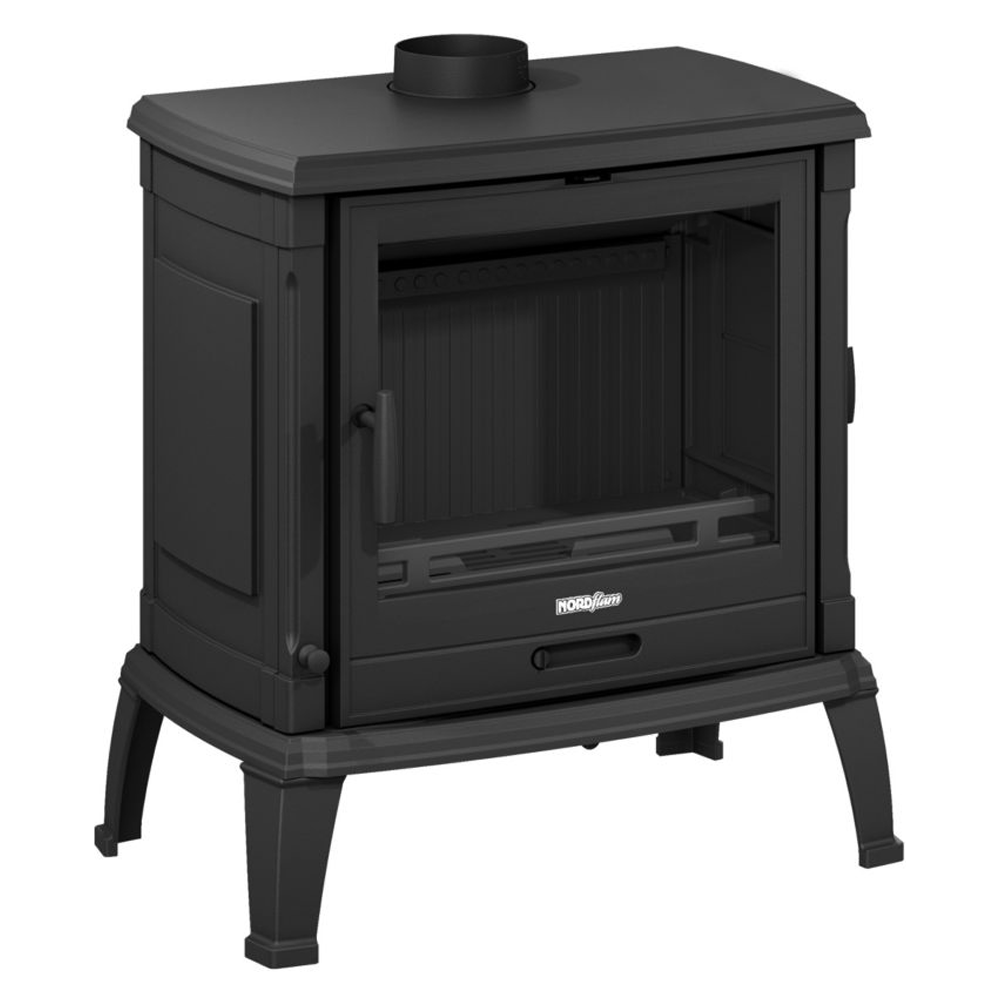

Would the Nordflam freestanding stove fit?

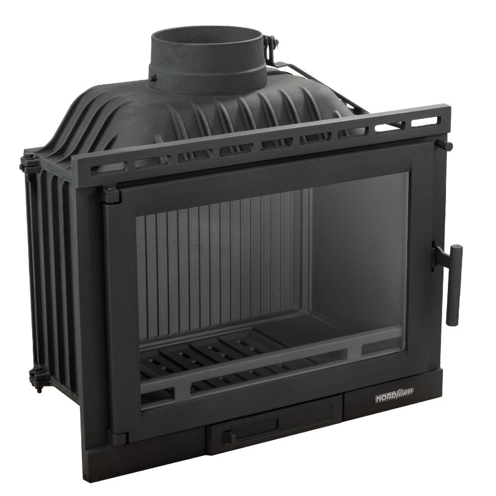

Thanks for the reply, yes the first one looks like a perfect solution but unfortunately I was not able to find anything similar in my region. The second one might be able to fit in with little adjustments. All in all you guys helped me to conclude that the best solution is to fit an insert inside and I will definitely do that. Now I just need to decide which one and it comes down to these two, Nordflam Etna and Nordflam Toria. Since my living room is pretty small I think Etna will be enough since it has a lower price tag. I'm going to make raw models of both with plywood just to be able to visualize how those two would fit and decide definitely. Thank you for all the help!
These inserts look like they are designed to have a grille above the fireplace to vent the heat into the room. Check with local installer for the best practices and heat.
