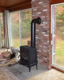

You will find that you need to shut down the air all the way sooner, or the stove will get quite hot.
I watched an official Jotul video, and although he didn't specify exactly where he set the damper after filling the stove with wood, it sort of looked like it was fairly open, like maybe 1/3 open. Are you saying that once the wood appears to have started burning well, I should immediately close down the damper completely?
Note that the manual shows thermometer placement at the sides of the stovetop patterned area.]
As you saw in my video, I had the thermometer at the front center. The side areas were considerably cooler. So when people are saying that they cruise at a particular temperature, they're referring to readings taken off the side like that? If that's the case, the stove wasn't as hot as I thought.
I mean, the fire I had going in that video was a thing of beauty. There was zero smoke coming out of the chimney, and I was getting good heat.
