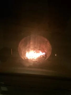

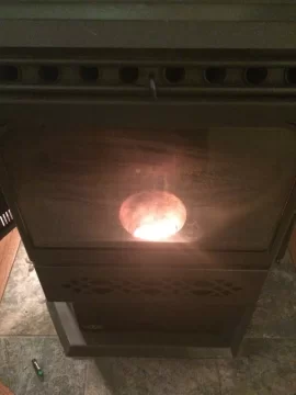

So, put vacuum switch leads back on, restarted stove from fresh, on HEAT #1 setting.
8:18-started stove
8:21-fire starting to build in pot
8:23-fire is larger & COMB fan kicks on
I look at the panel: #2 light is now flashing....cannot adjust flame; pellets have stopped dropping
8:24-flame is dying
8:28-flame is very small, with some pellets still remaining...COMB + EXH fans are still running:
here's what it looks like @ 8:28 ish:
[Hearth.com] Napolean NPS45 ..is it dead?
8:34-flame is still dying... both fans are still running
8:35-""
8:36-""
8:37-""
8:38-"" pellets are almost burnt up
8:39- COMB fan just stopped; just a few red pellets left in the pot
8:41-pot is empty ;EXH fan still running;Heat#1 setting light ON; #2 light still flashing
8:43-hit the power switch: #2 light flashing only...
8:44-pulled the plug.
