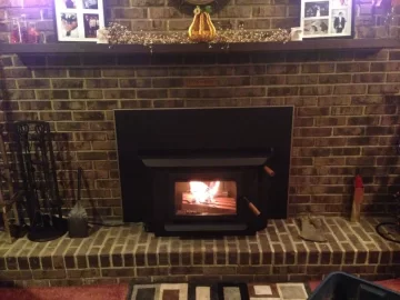

I just purchased a 2200sq ft bi-level house and installed a blaze king princess insert into the existing fireplace.

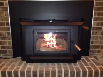

I wanted to say thanks to all the members that answered my install questions and I wanted to share some pictures. I still have to install tile in front of the hearth. I am having a hard time finding tile I like.
I have been very impressed with the burn times and the controllability of the stove. I had an englander nc30 in my last house so that is what I have to compare blaze king princess insert too. I have only been burning tulip poplar and am seeing anywhere from 12-16 hr burn time depending on the thermo setting. Compared to the englander this thing has such a consistent heat output. This is what I was hoping for. The englander would throw a ton of heat but only would go for 10 hrs.

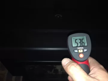

I need to get some good wood in the stove to see what it will do as far as heat output. With the poplar the stove top temps like to sit around 350-450 and this is not enough heat to keep the house in the 70's like I would like. This is also due to not having the air circulating correctly yet. I have to install to floor vent in the stove room. I hope this helps.
I do have one major problem... Most of my wood is cut 20". I have about 10 cords to cut shorter.
We'll anyway... Here are Few pictures .

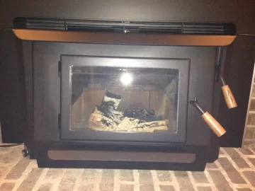

Damn, brand new insert, and you bent the fins on the top vent already. tisk tisk.
LOL, looks good man, keep us posted on how it puts for heat in the cold weather.
Yea. I bent the fins taking it on and off 10 times trying to get the top and side pieces of the surround to line up perfect. I keep on forgetting to straighten them once it gets hot and bends easy.
My convection deck came brand new with bent louvers. NIB. It would be tought to weld such small pieces of metal without some heat distortion. Also easy to bend them back though.

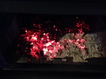

Yea, i have been burning some red oak and hard maple in it on a few cold nights. I certainly puts out good heat when you open up the thermostat more. When it was in the low 20's i was running with the thermostat half open i was able to keep the house in the 70's close to the stove and mid 60's in the far bed rooms (2000sq ft bi-level). With it at this setting i was going 10 hrs before reloading. There was plenty of coals but just not enough heat. When running the stove like this it ran a lot like a none cat stove with the heat fluctuations and temp swings. But then again it is a wood stove... I have some heat loss issues i have to address with the house and it will really help maintaining my house temps.
This stove is certainly a lot less work compared to the englander in my old house. There is always enough coals to reload even when you have to extend your normal loading patterns. I can easily go an extra 2-3 hrs and not think twice about it. The englander would be cold where this thing you just rake out the ashes and then... wahlaa there are tons of hot coals. then throw on the wood.

I never leave it wide open the stove top temps would get to hot. It will get well above 700 if left wide open for longer than 15 mins.
