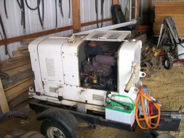

I'm not sure about your mepo18a, but make sure you do your homework. I have a 1942 genset with 4 cyl hurcules that was originally a 3 phase unit at 115V. You HAD to equally load the 3 phases, which means that you couldn't just pick off a phase and run lights, a phase and run your refer, etc. If you did not equally load it, it would choke that engine quite easily. Oh, an just for info, the hurcules on mine is rated at 11hp (old school, low rpm).
What I DID do was rip the old gen head off and replace it with a new 10,000 watt 110/220 belt driven head. Figured out the pulley arrangement and a little increase in rpm and bingo. Electric start genset designed for 100% duty cycle.
What year is the one in question?
Here is a pic of mine for reference:

i have an m5 genset looks just like yours, hercules engine 15 hp i think
3kw genset i sucessfully split the phases on mine, possibly a bad genset on yours
really not even worth splitting at 3 kw
wont run much
want to do what you did replace with a larger genset
but i hate to tear it apart kind of a peice of history but not worth much

M5 genset has a hercules ZXB engine that produces 11 hp at 1200 RPM. Thats why I used a pulley config that would allow me to bring up the rpms of the engine. I am currently turning at ~2300 RPM (by ear). It still won't pull a "true" 10,000 watts but its fairly close. If you were looking at something around the 5000 watts, you could probably get all the power you need at 1500 rpm or so. Quite, and fuel efficient at that rate.
These engines had such a low HP rating because of the intended low RPM. It really isn't even into its torque curve at 1200 rpm.

Mine burns a touch over 1 gal. per hour at about 60% load (around 4500-5000 watts). Other than honda - I don't know any other box store gensets that do much better. Maybe a little, but lets see how they run after a week long outage. I would trust mine to run 1000 hours without giving it a break.

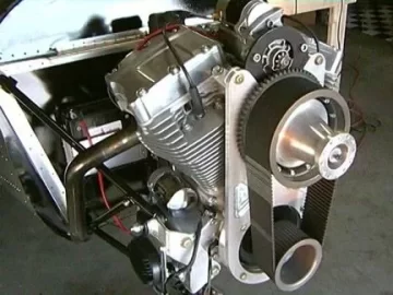

Harley please.

Wanna bet that, that motor is an S&S and Not a HD?
