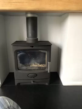

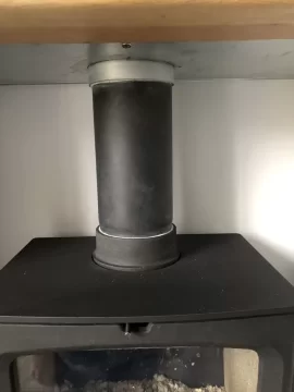

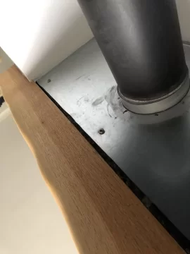

Hi i had a log burner and wood mantel installed and the beam seems to be getting quite hot, is there a deflector or something i can get to stop this ? my measurements are
beam - just under 32” from hearth
beam - 12” above burner
beam - 4.5” from pipe

That does look quite close to the stove. What does the stove's manual say for clearances above it? What stove make and model is this?
A shield can be fabricated and will help, but only within reason. It would help if the mantel was mounted higher.
the make is newman fireplaces ltd and is a easedale 5 Se , i can’t see in the manual where it’s says about distance, it was fitted by a hetas engineer a few months ago
Unfortunately, I am unable to locate the manual to help. Newman's website offers little and does not appear to be up to date. The Easedale is not listed.
Was the beam in place when the stove was installed or did it come afterward? It is closer than would be permitted for any stove that I know of here in the states.

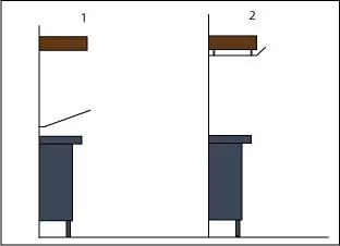

This is what a mantel shield looks like. It should extend for the full width of the fireplace opening, it should be on 1" spacers to create an air gap and can be painted.

I can’t recall a stove that allowed the mantle to be closer than a combustible wall. I could be wrong.
