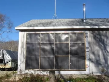

I made a 10 by 16 copper aluminum collector following what Gary did on www.builditsolar.com. Wasn't hard to do, took some time and so far its done what I wanted it to do and thats keep my shop from freezing. I'm using it on a radiant floor, 22 yds of concrete, 1100 feet of 1/2 pex buried in the crete. Lowest temp I've seen yet is 44 and this has been a rough winter for sunshine here in Maine, lots of snow, average temps. I have a stove for when I'm out there for any length of time but I've found when temps is around 50 I can do some work pretty comfortably for a hour or 2. Its obvious I need more collector to really do the job but I thinks its worked pretty well considering. I have $2500 or so in the whole setup including the pex in the floor. Lots of labor but I'm not a slave to heating my shop, and based on my experience with solar DHW in my house maintenance should be minimal. One thing I thought once february hit I'd see high temps in my floor but it takes some energy to get 22 yds of 44 degree concrete up. My Delta T across the collector is usually 5 or 6 degrees.

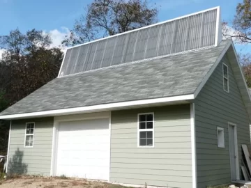

One thing you might think about if you have more room for collectors is to do some solar air heating collectors to supplement the water heating ones. I think they would go together pretty well with the water heaters keeping the shop somewhat warm over the whole 24 hours, and the air collectors dumping in more heat just during the time you are in the shop in the daytime.
This is what I use: http://www.builditsolar.com/Projects/SpaceHeating/solar_barn_project.htm
Its hard to beat the BTU per $'s :)

Dang! I'm jealous. That's a lot better performance than I'd expect, you must have a pretty tight shop there. I don't know what kind of underslab insulation you have, but regardless, the subsoil has cooled off over the course of the winter, which is holding down the temp. Even if the solar barely keeps the temp above freezing, the heat sure helps keep things dry. I've been planning to do something similar eventually, about 12'x28' vertical unglazed steel and poly collector, ie black painted rib formed steel siding with 3/4 poly run in the ribs, extremely low efficiency, but high btu/$. I don't mind working in freezing temps at all, especially if there's sun coming in the sliding glass door, I'd be happy to keep my tools dry.

I planned the shop around the solar, in other words I knew I could get a limited amount of BTUs so I made sure I was tight and highly insulated. R54 ceiling, R33 walls, 2inches of Dow Blue under the slab and around the perimeter. I built the walls, covered the outside with 2 inches of urethane foam, then did the sheathing. Under the trusses I did 2inches of foam and then had cellulose blown on top. The shop is tight with the only real leak a 10 by 10 garage door which is r17. The building is 30 by 34, 12 foot ceilings. Lots of folks said I went too far, there will no payback, they might be right in terms of bean counting but in terms of comfort, the place is awesome. The payback is in comfort the same as it is in a cold climate and well insulated house, no drafts means extreme comfort when its 10 degrees out
Benjamin,you're right about the subsoil temp gradually dropping.I put a temp sensor under the slab of my building about 5 or 6 feet in and approx. 2 feet under.This winter it bottomed out 48* or 49*F and recently it has climbed a couple degrees.
Wallworld how about some pictures?
My building is insulated about the same as you with the exception of side walls-I'm a little less.My collector is also based on Garys design.Works well.
