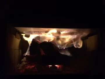

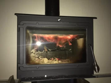

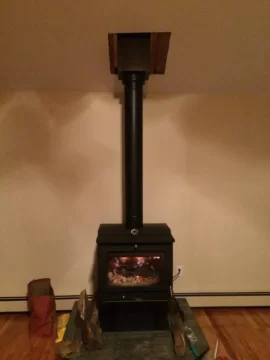

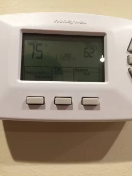

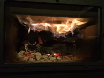

Thanks for the advise, last night I tried a top down fire, worked horrible. I am under the conclusion that the "seasoned" wood I bought is wet, as I have hissing when it begins to burn. 180 for a cord seasoned verses 330 for a cord of kiln dried. Lesson learned. Dried birch burns really nicely. The thing that bothers me with this stove is that I do not feel I have a lot of control with the damper. My friends stove has tremendous control with his lever.

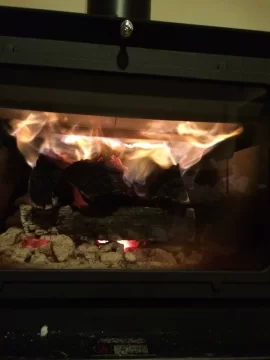

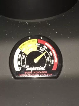

Ok moment of truth, lots of pictures. This was last night after our 14 inch blizzard in NY. 12 degrees outside after I came home from work. 5 logs, I had damper all the way out to low, had vigorous flames going on and temp rising. Wife is happy now as you can see the thermostat.

It can take you a few times to get the hang of the top down fire. the key is lots of small pieces on top with newspaper or super cedar. you can put some big pieces in the bottom but the point is to establish draft quicker,start getting some heat quicker and create a nice bed of coals, that way the reload with big pieces catch fast and you can set everything for a long run. Of course if wood is not dry, can give you hard time one way or the other. Like i said the key is small/skinny pieces at first, create a bed of coal and do like a hot reload on those coals with big pieces. including that helps if your wood is not at low MC.
When secondaries take place you will gain higher temp for awhile. you will learn when to start cutting air back to have a little more control but at those outside temp and a good install like it looks you have, draft will be good. you will have a little of hell in there for sure. But give you some time to learn to operate it at you location and setup. same stove in different places and setup will work different.

Every setup is unique. You will get better at this and will become a very savvy wood buyer too. We have all had to start out like this at some point.
Comparisons to other's stoves often if fruitless as their setup is different. What make/model is your friends stove?

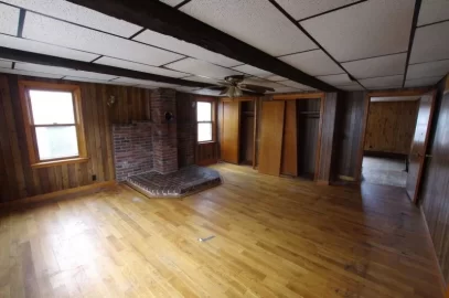

Chiming in as I'm awaiting delivery on my Summers Heat rebrand of this stove. I'm hoping its what we need for our home to offset the insane heating cill we've been seeing the past winter. We've basically been running space heaters and a propane burner since we picked the house up last spring - it was cheap because someone had gutted the electric and heat systems. We took care of the electric, then ran out of $$$ to deal with the heat.
The house has an absolutely gorgeous hearth in it, as whoever built the place back in 1925 obviously was intending to heat the entire place with wood. The now-gutted oil heat was an afterthought.
I live in Maine, so its obviously going to (hopefully) see a lot of use in the future. I'm a complete novice at the whole wood burning thing so I'll probably be popping up with stupid questions from time to time. :)
For now, we have to wait on someone to come out and clean and pipe the chimney - whoever had the place before us somehow managed NOT to burn the place down despite there being (literally) 3 inches of creosote caking the inside of the chimney. Its an 8 or 10 inch flue and I don't think I can even fit my hand up inside whats left of an opening in there. on the bright side, there obviously hasn't been a chimney fire so hopefully the lining is still intact and won't need replacing. Its so plugged I don't even have a cap on the hole, despite us hitting temps close to -20 a few times so far this winter. The cold simply isn't making it past the creosote plugging the shaft.
Here's a shot of the hearth which will hopefully be put to proper use within the next few weeks. That stove is going to look *nice* on it.

Hello neighbor . . . well you're a couple towns over from me . . . close enough when it comes to Maine to being called a neighbor. Welcome to Hearth.com.
Have your chimney guy check things out real close, but I'd bet you need to have an insulated SS liner put in.
Two reasons...
1. Just looking at the way that chimney is built I bet the "clearance to combustibles" requirement is not met.
2. The Madison needs a 6" flue.
A 6" insulated liner solves both issues
Is that built on a slab? If not, then look at how the hearth is built too...you might possibly need to deal with "CTC" issues there too...hopefully not.
Two reasons...
Luckily the Madison is ember protection only, so the hearth is probably OK. The bottom of the stove is a big removable ash pan + air intake chamber (outdoor air kit pipes directly into the back of the pedestal) so it stays cool to the touch.
The hearth is 6 feet wide by 5 feet deep (minus 18 inches for the chimney) built on a double layer of brick. When we had our quote the pro who came out to inspect things said, "Yea, you should be able to take anything on that" so I *hope* I'm good.
