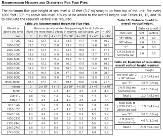

At sea level those two stoves will work with a 12 ft chimney. I think the True North TN20 is around $1000. It's made by PE. Otherwise get an Englander 13NC for $750, build a well insulated hearth and put 18 ft of flue on it straight up. It's a good stove too, just needs a bit stronger draft.

Will the chimney be going straight up? Turns add resistance.
I would pick up and extra length of stove pipe and a roof brace. Install with 15ft total flue and if that works well, great. But if not you will have the extra pipe to extend right away. Return the pipe if not needed.

Thanks! I would like for it to go straight up. But if that does not work for some reason I would need to do a 90 degree through the wall and then another 90 degree up.

If at all possible go straight up, particularly if chimney height is a challenge. Every 90º turn costs about 2-3' off the chimney height. Straight up is also less expensive for parts.
I would strongly advise against going out the wall at altitude. " Because of the effects of negative pressure, we cannot guarantee the performance of exterior chimneys" has been my standard disclaimer for years. I've had good luck with True Norths working up here at 8250'. 15' minimum height is absolutely required, at our old house the pipe stuck 7' off of the 2/12 roof
