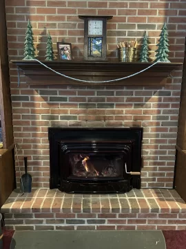

This is my first post here. I just moved to a new home and am shopping for an insert. I have some experience with a free standing wood stove from my old home.
My new house has 3600 sq. ft, the downstairs where the stove will be is approx 2600 of that. I'm NOT looking for whole house heat, but rather supplemental heat downstairs. The existing fireplace is a masonry fireplace and the chimney is 30'
