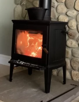

Looks closely at this pic.. this is going full blast with the cat engaged. Look at the lower left hand corner of the class you’ll see some build up. That’s as bad as it gets, you just need to get the stove hot once a day or so to burn any junk off the glass. It stays very clear and visible.
logs over 16 will need to be canted at an angle. This is ok every now any then but you definitely want 95% of your wood to be the right size. I just simply work with processors that cut to size and boom problem solved.

@Rob_Red I notice that your stove looks pretty close to the stone wall. From what I read in the manual, I thought you had to leave some space at the back to eventually change the Cat?
That’s just how the picture looks, it’s actually spaced from the wall at the clearance hearthstone specifies. It’s somewhere around 15 inches. Which is plenty of room to get to the cat.
