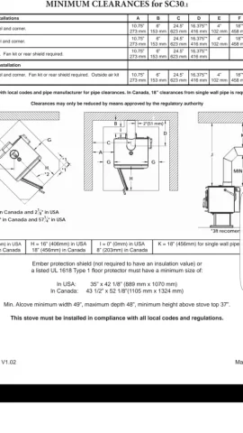

Just found the PDF for the minimum clearance I can actually do a little better so thats good. Just need to sit down and figure out hearth size.
According to this, as I read I dont need any R value just a basic hearth?

Correct, the hearth for the Sirocco only needs to provide ember protection. And it sounds like you will have sufficient draft. This is shaping up to be a good plan. The only option I would suggest investigating is going up straight through the house. That will keep the flue gases hotter which is important with these stoves. But that is not to say your current plan won't work. With a tall exterior chimney you may need to clean the chimney more frequently and it probably will cost a bit more, but for some layouts that is the most practical option.
