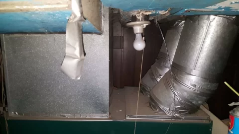

How do I make it code. The furnace hasn't been used in 10 years. I have no clue which vents do what, have three in this room two of which will be within 10'...That will be much more efficient. More heat and much less wood consumed. The heating success will depend on how open this room is to the rest of the first floor and stairwell.
Note that looks like a return air register. If so, that is a code gotcha. It is supposed to be at least 10ft away from the stove. Not a show stopper but a consideration for inspection.
Well I would follow the ducts in the basement and see if they are supplies or returns If you never use the furnace you could always disconnect the duct work from them and patch the holes if any of them are returnsHow do I make it code. The furnace hasn't been used in 10 years. I have no clue which vents do what, have three in this room two of which will be within 10'...
And that would be code if so done deal, the furnace is never used.Well I would follow the ducts in the basement and see if they are supplies or returns If you never use the furnace you could always disconnect the duct work from them and patch the holes if any of them are returns
Yes it would be to code if you closed them off. Also if they are supply ducts there is no problem at all.And that would be code if so done deal, the furnace is never used.

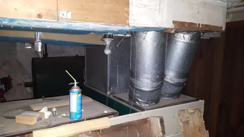

That is what it looks like to me yes but its hard to tell from that picIt seems to me that the circular ones are the cold air returns, correct? The one off to the left is the actual heating part?
Which side has the burner under it? That will be the supply side. If you pull the access cover on the other side it will have the blower and filter in that side it is the return side.Is there a way I could tell?
The returns can usually be told from the supplies by the vanes. Supply vents usually have a damper with a little handle that allows you to adjust the flow. Return grilles are unrestricted. Sounds like you have it figured out. Now may be a good time to look for a freestanding china cabinet .How do I make it code. The furnace hasn't been used in 10 years. I have no clue which vents do what, have three in this room two of which will be within 10'...
