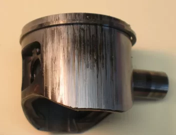

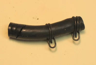

No problemo. Maybe even the scored piston that just came out of my own used 357XP? :shut:
"Rope" compression test wouldn't work on mine because it had auto-decompression. I shoulda pulled the muffler and looked, but I didn't. Kind of a "tailgate" purchase. Lucky I didn't pay that much for the saw. Photos show:
1. The root cause of the problem - cracked auto-decompression hose allowed a massive air leak which leaned the saw out too much, starving the moving parts of oil.
2. The scored piston and ring.
3. Final bill after a complete overhaul. It needed many other new parts, including a new clutch - $200 worth in all.
I paid $225 for the saw, so I now have over $500 in a totally reconditioned saw (replaced the auto-decomp with a manual valve). Runs like wildfire now, but big time sticker shock. Amazingly, this same saw cut a few cord of locust with little problem. Only outward symptoms were hard starting, poor idle, doggy throttle response and cutting out before it had a chance to get hot.
Now I know. Always pull the muffler and look at the piston. Two bolts and you're looking at the inside, and that tells you lots about how hard the saw has been run.
