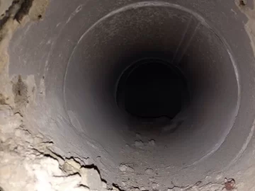

You wont need to clean your horizontal section if you are burning dry wood. Everytime i look in there i say "that was a waste of three minutes". There is always like an 1/8" layer of dust in the bottom. The clean out tee collects some fine ash too. I clear that maybe every two cords and i might skip it this year now that i trust the process. I havent brushed my chimney in over 15 cords worth of wood and i can still see a bit of reflection when looking up the inside.

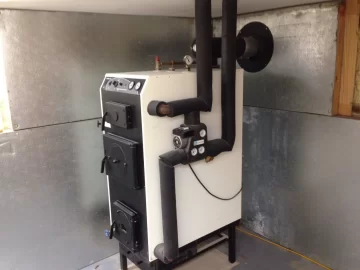

And why not some pics
  • Long term install plan - Vedolux 37 - Chimney questions
Even if it's not something I need to do often, I would like to keep all the maintenance to a minimum of fuss. The Vedolux's easy cleaning of the tubes is one of the reasons I am sold on it, and if I can clean the chimney and horizontal section out quickly, that is a bonus, even if it's once a year.
There was a comment made about more difficult access to the chimney top with the rear wall install, and that's true, but I usually have good luck with cleaning them from the bottom (especially with a bottom cleanout) and I have scaffolding I can set up pretty quick to get up there if I really need to. I think the rear chimney wins out in the end due to practicality in the basement.
I have a natural draft Varm - I think the fan ones are even more efficient than mine. But I have not swept my chimney at all since I started it up, going into my 4th winter with it (I think most gasifiers with storage are the same there anwyay). I will take a look up it before winter sets in, but last year it looked about the same as Reapers above.
