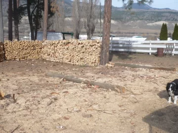

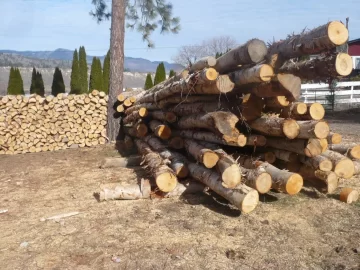

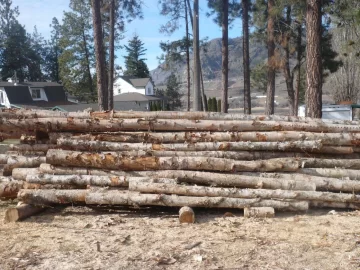

Making progress,we have about 10 cords done I think half done.The log pile still looks large and unstable so I'll give it a bump with the big tractor before I cut again. The good weather continues , I truly feel sorry for you folks in the east what a winter you are getting.

Wow - looking real good, very nice piece of property to.

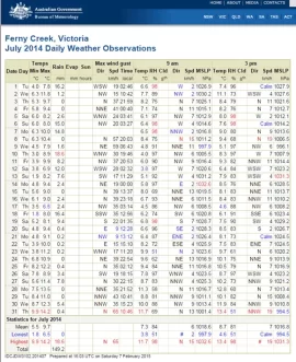

A lot of wood in a 320 ft tree.How cold does it get there, looks like a warm climate?
It very rarely gets below freezing. In fact i have been here 3 winters and i have never had a frost on the car - i think its in part due to all the trees. Average daytime temp is ~ 10 deg c (~ 50 deg F) with an average low of 5 degrees (41 deg F)
Our 'middle of winter' is July - here's 2014 daily temp etc... nothing like you guys, but the houses here aren't set-up for a cold winter limited insulation, no double glazing etc...... so it 'feels' cold unless you have a wood stove ==c

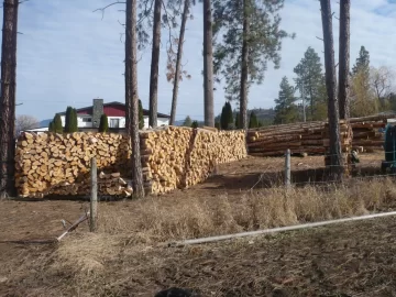

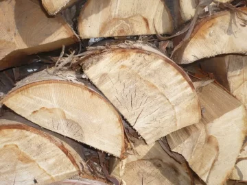

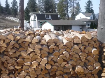

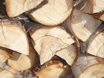

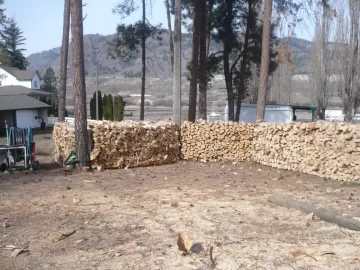

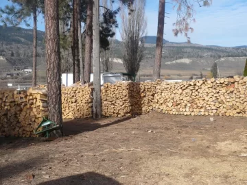

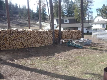

We have finished CSS , about 20 cords it was a big job but it sure feels good to be a few years ahead. The first stacks show nice checking already so I'm still hoping it will be ready by Oct.

thats sweet. i would love to get a load like that.
Very nice wardk! That will be some fine burning wood next winter!
Edit: Yeah it probably started checking within days. I find that with mine as well.
Thanks Seanm , it kind of sets me free one big job that I don't have to think about for a while.
Yeah when I see firewood that needs processing I see work to find time for, and when its c,s,s all pretty I see it as an accomplishment and a chore complete.
