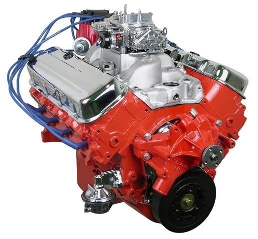

I've built a few GM small blocks over the years and had a totally insane 700 triple triple that I built in a snowmobile. The SB's were easy with the oil because you just drain it. The sled needed the synthetic oil pumped out of the tank for break in.I didn't read your post before posting my reply a few minutes ago, but I respectfully disagree. When I google Engine break in, the very first link I see from Summit racing mentions the oil. I've heard this and seen it for years. I didn't search this out, or look for other articles, just the first thing that popped up, and I buy a lot of parts from Summit.
Engine Break-In Guide: 10 Tips to Help Properly Break in Your Engine - OnAllCylinders
Proper engine break-in procedure is critical. The right steps during this procedure can save your engine, your bank account, and ultimately your sanity. With help from the engine experts at ATK High Performance Engines …www.onallcylinders.com
