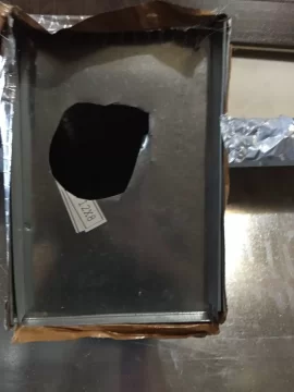

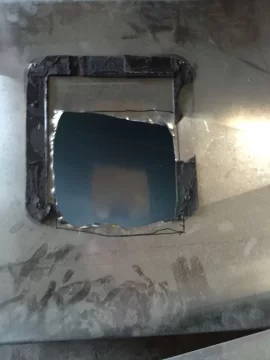

Anyway, in these sub zero temps we have been having, I noticed my cold air temp at the blower box were running ~5° colder than the house temp upstairs. I did not remember noticing this back when the weather was not quite as cold. I also noticed the temps near the ceiling of the basement were consistently hovering around 80°+ as long as their was a fire in the furnace. Even when the fire is at the end of the burn cycle and there's just coals left, the temp at the ceiling was still mid 70's in these sub zero temps.
So, what I did was box out and raise the intake of the cold air to almost the bottom of the TGI rafters. It's 16"x18" and about 6' in height. I'm now pulling in much warmer air and hence my plenum temps have noticeably increased.
Last night it was -4° at 9:30pm when I went to bed after loading it up with 70lbs. It was -6° at midnight and when I woke up at 6:30am it was -9°. The house was 68° at midnight and 67° when I got up in the morning. The blower was still running when I got up and there were plenty of coals in the furnace 9 hours later. I even had the blower on high the whole night, which I could never do before because the plenum temps would get too low.
I'm now going to play around with my SP's again to see if I can drop my supply SP a bit seeing I raised it last winter in order to bring my plenum temp up some. I believe right now my supply SP is +0.22" with the fan on low. Would be nice if I could increase my CFM w/o decreasing my plenum temp much. I'm also guessing, with the addition of the new cold air duct, my return SP also increased a bit even though it's 288 sq inches and only ~6' in length.
Keep in mind, this house used to use ~1300 - 1500 gallons of LP a year......so it's not the most efficient to heat LOL
Anyway, I would have never noticed this if I didn't have thermometers placed to monitor temps. I believe doing so really helps in getting your system dialed in.
