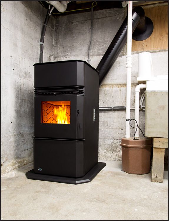

Also, don't forget a few pics.....or this never happened ;)
I finally had a chance to photograph the Kinderhook. It's hard to make it look good when it's in your basement!

I'm really, really liking it so far. In fact, I've really fallen in love with this device! I've been joking with my wife that I could put a recliner down there in front of it.
Our kitchen and basement are comfortable and cozy for the first time ever in winter, I don't mind the hands-on stuff that it requires, and I think the numbers are going to look very good for the running costs.
I haven't had it running long enough to really start getting a feel for the pellets. I held off on burning until I got it inspected/permitted, based upon someone's suggestion that it not looking like it's been running when I didn't have that permit yet. (I do now). I posted above about the difference with Green Supremes and the Fireside Ultras, but I haven't yet tried any of the other 9 brands that I have.
I DO like looking at the flame.... I always have. I find it hypnotic, relaxing and mesmerizing at the same time. I could VERY easily see one of these in a future living room or kitchen. I honestly wasn't expecting THAT... the romance.... from a pellet stove!
