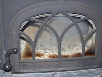

I actually thought of you this morning and so I took a pic to show you what black I typically get. This is from an overnight burn . . . went to bed last night at 10:30 -- secondaries were firing with no issues and I was able to "close" the air control. 72 degrees in the house this morning. As someone mentioned earlier, sometimes you will get some black in the corners . . . the rest of the black is mostly where the ash fell against the glass preventing the airwash and heat from searing it off. As I also mentioned, I will occasionally get some black when a split or round falls against the glass and burns there. In either case, no big deal.
Before I relight the stove I will be brushing away the ash away from the glass and I can almost guarantee you that the next fire will burn off what little black is there . . . or if I was anxious I could use the wet newspaper/ash . . . but I'm a patient guy . . . besides the next fire will most likely be this evening.
You may also note that you will always get some build up of light fly ash (that's the gray haze) . . . again, if you're looking for a pretty stove the damp newspaper will remove this slicker than swine flu. Unless I have company coming over I usually only do the glass cleaning once a week as part of my regular weekly cleaning duty.

My entire front glass looked like the corners of yours. But like I said my wood was sizzling and I never really got up to high temps.
Last night I decided to light a small fire to take the chill from the house and wanted to view since my glass was now clean. I found two of the driest pieces of wood I could find from my measly pile. Two fairly thick 16"ers. I laid them east-west with some kindling on top and then some newspaper on the very top. Although the fire stayed lit without any "encouragement", it never really caught on until late (2-3 hours later), hence my stove never really got too hot. Maybe it hit 275-300 tops at its hottest. Granted, I was not looking for a big hot fire, but I thought it would get hotter than it did. Was this a consequence of the wood quality or just the fact that I only put on two logs and some kindling? (I never did add any wood-went to bed before the fire went out)
I enjoyed this fire since it was not too cold outside but I am not sure if this is something I should be doing regularly - won't I be getting more creosote buildup as a consequence?
Also...the glass was not bad this morning, a little haze in the corner sort of like yours, jake.

Yeah, I'm pretty sure it's your wood that is blacking up the glass . . . and preventing you from reaching higher temps.
