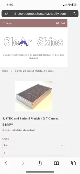

Yikes looks like $180 or $200 for the cat.
$70 for each side plate maybe, i also saw one for like $57
No the catalyst version but this might help.
Yeah the specified cat for that stove is pricey. $255 at woodmans!!
I found a comparable Buck model that is within .125” of all dims of the original…for $165
