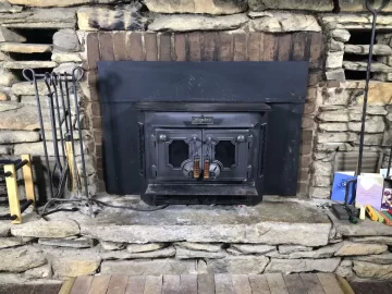

Here are a couple of photos of the stove as installed, just for the fun of it. It really is a handsome stove. The chimney/hearth was built in the 1970's and includes a metal 'heatilator' firebox. Thus the vents on either side. It actually had a wooden lintel (what could possibly go wrong?), which caught fire once long ago, thus the smoke stains to the left. The fireplace is massive, a full 36" high and nearly 48" wide before I shrunk it by adding brick around the sides (and replaced the wooden lintel with brick!). Still, it is 42" wide, thus the extra surround. As a fireplace it was voracious, consuming wood by the armload every hour or two and sucking cold air in through every crack in the house. Way better with an insert. ;-)

This is my first season with this stove. The freestanding stove in the pix worked for 10 years providing heat for my entire house, all winter. I think a little gray paint is not out of line for that level of service. I would also say that if I had to run the stove so hot that it scorched the paint on the door, and I still had to add a Magic Heat to get enough heat out of it, then perhaps the stove was not producing enough heat. I will say that once I took most of the firebrick out of it, it probably doubled the heat output. I understand that liability concerns require that the stove not get too hot, but hot is what I want out of a stove. Making heat is job one. Everything else is secondary. I know, you're probably appalled that I took the firebrick out (I only actually took it out about halfway down the sides and back of the firebox to increase the radiant heat output). But firebrick is a really effective insulator, and the entire firebox was surrounded by it. I watched roaring fires and vast amounts of wood flaming away and wondered where all the heat was going (up the chimney). Once I took out the firebrick and added the Magic Heat, suddenly I had a stove that burned a reasonable amount of wood and heated the entire house effortlessly. I would also note that the stove recommended no flue damper. I tried it without the damper, and with the damper, and I got substantially more heat with the damper. As I see it, there are lots of theories and lots of opinions and lots of "everyone knows" facts about wood stoves, but the proof, again as I see it, is in the BTU's brought into the house, and the amount of wood burned. More heat for less wood is better, so long as the wood is being burned cleanly and the stove operated safely. I work by trial and error. What seems to safely get more heat out of the stove seems to me like a good idea. That said, I'd be happy to hear your thoughts. I don't doubt that I have much yet to learn.

Everything you said about your old install tells me you were running the stove with to much air or you had excessive draft. A modern epa stove should be able to run pretty low flue temps while putting out lots of heat. And yes the fact that you pulled the firebrick out on an install that was already lacking enough floor protection on the sides is pretty scary. I suspect with your insert you have wet wood. Once you get a good wood supply you can then start to learn how to properly run the stove.

I think it is possible I have excessive draft with this new installation. The chimney is two stories and on the gable end, 22' tall from firebox to outlet. I think it would suck a cat out of the room it left unchecked. ;-)

It won't open on my phone. But right there is part of the problem. Modern stoves don't work well adding one log at a time. It works much better to load it up full and run it to coals then start over.

You load it get the stove up to temp then shut it back and let it cruise. When you start shutting back will vary greatly depending on your fuel and draft. You will have to figure out what works best for you. With my tube stove in this house I got the most heat 3/4 closed. My old house I got the most heat fully closed with one of the two key dampers closed 3/4 with the same stove. But that chimney was over 35'.
I'm definitely hearing what you're saying. I think it is very possible that wood which was dry enough for my old stove might not be dry enough for this one. I can't do much about that this year, but I lost a couple of big hickories in the hurricanes this fall and I have already cut them up and split and stacked them. They should be pretty thoroughly dry by next fall and ought to do better. But it's pretty hard to get two seasons ahead on wood, with this stove consuming as much as it does.

Hickory is a slow drying wood. I think you would find quite a bit of improvement if the wood was fully seasoned.
The CFM stove shows signs of overfiring and with the stack robber this is simply not comparing apples with apples.

The general consensus here seems to be that my wood is not dry enough. I think I have to agree. I have some wood left over from last winter, two years dry, and I definitely get more heat when I burn it. I'll start with that and see where I go from there. Thanks for all the comments!

And here's the new Jotul! Definitely the most handsome stove of the lot!

Looks like too much air in there at first glance. It's not operating as designed. Try what others have suggested. Load it up full, let temps get up and then slowly close back the air in steps. (I usually wait 5 minutes or so after an adjustment to make sure it's still burning well) Let it burn to coals. Rinse. Repeat.
If you're not using a moisture meter and your wood has only been seasoning for a year, it's not dry enough is my bet. My stove runs MUCH better this year than last year with wood that's now 2 years dry.
