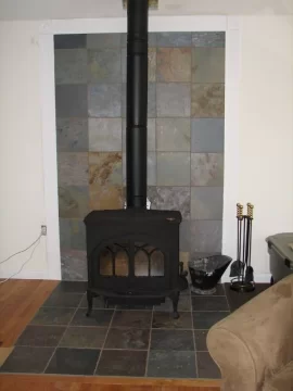

I have owned both the F500 and now the F600(due to larger heating area) Both are nice. I do like the door setup on the F500 better then the F600. But with both I rarely used the front door if at all. My F600 can and has achieved 10+hr burn times with good quality hardwood. I am getting longer burn times with the F600 then I have with the F500 due to firebox being larger. My family has always stuck with Jotuls for ease of use and build quality and the beauty of the craftsmanship.
Oh and you can open the ash pan door a bit if you are careful to help stoke up the flame =) It is not like your stove will explode or melt in front of your eyes... But as others have said becareful with it as you can and will overfire if you forget to close!!!!! I have owned Jotuls for years with no problems.
Also if you have not already purchased one get a stove top thermometer.
