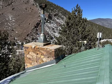

This morning I added 3' (and bracing) to the stack. We'll see how things go. I plan to keep using the stove as I have been and see if I notice any differences, before changing anything else. Started getting ~40mph gusts right about the time I was finished, and the bracing appears fine. So, fingers crossed that I see some improvement in some way.
Before and after.

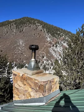

Maybe a naive question, but your flashing on the up side of your chimney seems to not do much this way? (It seems to end above the roofing.)
Hope that helps. If it does, you might want to switch everything topside to class A chimney pipe with an anchor plate. That will keep the flue gases hotter which will help draft and reduce creosote buildup. Is the 6" chimney liner for the Kuma insulated?
If I understand what you're referring to, that's just how it was when I bought the house, and when my installer put in the insert and chimney and such they didn't mention anything about it. I am not sure I understand what you mean exactly, though - are you talking about the flashing keeping snow off the masonry?

Yes; water running down from your roof to your masonry chimney does not get diverted before it hits the stones. From what I can see the seam is caulked or so?
I'm no expert, but it looks fishy to me.
I added some sealant a few years ago because I was getting some minor leaking, but I never swung back around to address it in any larger sense. I'll ask my chimney sweep and the guy who does most of the work on my home about it, though. I appreciate the suggestion.

After two weeks with the additional chimney height I think I can comment on it.
The extra 3 feet seems to have made a significantly positive difference, but I still have to use the tricks I have learned along the way to ensure the fire burns well.
If I keep making fires the way I have been recently, with the additional height in the chimney I seem to see a pretty consistent, significant increase in cat and blower temps, and durations of those temps, and though I still get some smoke, it seems to be significantly reduced and in some cases clears up into nothing visible way sooner than it otherwise would.
As far as specifics with regard to draft, my calculations (accuracy questionable) suggested the additional 3' would gain me ~16% more draft, and that seems to be about right on. I am consistently measuring ~.02 inches of water column more that before increasing the chimney height. Where before a good burn would read about .08-.09, now I'm reading .10-.11.

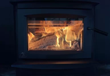

However...awesome burns like that are spotty. Things will be fine for some variable number of days, then all of a sudden they'll suck again. And usually shortly after they suck I get up and check the chimney, and it's clogged nearly beyond belief.
Because of how well the stove runs now (when it runs well) I think I'm down to environment or wood as continuing problematic factors.

I replaced the Kuma Sequoia (with the improperly sized liner, 6" instead of 8") with a Timberwolf T25i (also sold as the Napoleon S25i), which is made for a 6" liner (the largest diameter I can get through my chimney), and the difference is amazing. My burns are all super clean, way hotter, the glass stays clean, there's hardly ever any smoke out of the chimney, etc. Once the fire's going well (which takes no time, at least compared to what I was used to) I can run the box with the intake at the minimum setting and the fire is still just great. I also personally like that it's not a cat stove, just one less thing to fuss with. Watching the flames out the air tubes is very cool.
I would like to reiterate that if I had the Kuma installed correctly, I believe it would be a great stove, and their customer service is outstanding. If I could have got an 8" liner installed, I would have done so and kept the Kuma, but it wasn't an option.
I guess this is just a lesson in how much not following the manufacturer's guidelines can wreck a stove's performance. "Duh", I know, but anyway, maybe this'll help someone. At least I learned a lot in the process.
