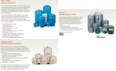

In Amtrol lingo a Thermal expansion tank for potable DHW use, its called a Therm X trol. The hydronic tank is an Extrol, and the well tanks are Well X trol. All trademarked names.
There are some cases where Therm X trol tanks are used in heating appications. A combined system, common in Califiornia and parts of Canada used the hot, DHW water via a fan coil to heat the space. So that system needs to be all non ferrous and uses a Therm X trol, coated tank. They are limited to operating temperatures under 140F. State water heater company sold this systems for years under the Apollo name. iIt may still be available.
There is also an online radiant company, from the New England area, that sells and promotes combined DHW/ heating piping for their radiant packages. Those require Therm X Trol type of tanks.
So the order taker may have heard Thermal Expansion, and being a well trained Amtrol dealer, just entered a Therm x trol on the order.

Thanks for the explaination of the nomenclature Bob. Very useful for future applications
What she gave me was a Well-X-Trol, not the nicer Therm-X-Trol. I now have the Extrol ready to be plumbed up. I feel like she should have known better since we were all talking about my project with a Buffer tank. I just grabbed the brown cardboard box she rolled in from out back, and I threw it in the truck. I only discovered it once I got home to see where it would fit!
