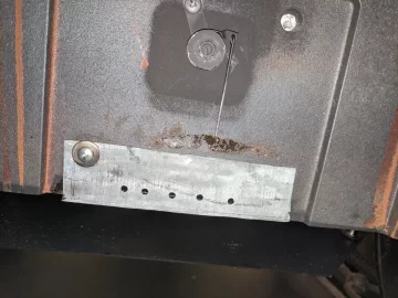

Here's a pic of the secondary air mod I'm trying out. Took a piece of 22ga galvanized and drilled some holes in it, and bolted it on. Seems to work well. I might need to add a couple holes because now the cat tops out at 1000 and smokes a little. (Ignore the burn marks, that's from some foil tape I had on there before). [Hearth.com] Intrepid II cat too hot, had trouble getting the temp down

Here's a pic of the secondary air mod I'm trying out. Took a piece of 22ga galvanized and drilled some holes in it, and bolted it on. Seems to work well. I might need to add a couple holes because now the cat tops out at 1000 and smokes a little. (Ignore the burn marks, that's from some foil tape I had on there before).View attachment 271001
This is gold! I love your technique of drilling holes to find the right amount of air, although I suppose you could just swivel the plate to expose a bit at the bottom. Maybe that might give more air to one side of the cat vs the other?
I think someone else said something about using aluminum duct tape to cover most of the slot. I like the idea of being able to adjust it though, to find the point where it maxes out at exactly 1500.
What size drill bit did you use, in case I copy you?
I think I used a 3/16 bit, honestly didn't pay attention just grabbed one from my drill case. Your optimum setup is probably going to vary based on draft etc.
Edit: it was 1/8"
I tried the foil tape first, but I found that once the stove got going the adhesive melted and the tape peeled off leaving that black gunky mess. I also messed around with a piece of aluminum flashing but found that it was too flexible and wouldn't sit flat so I couldn't get a good seal.
Whatever you end up doing just pay attention to the cat performance and fine tune it a little at a time. I have not gotten mine perfect yet but the stove feels much more controllable and doesn't give me heart palpitations like it used to.
