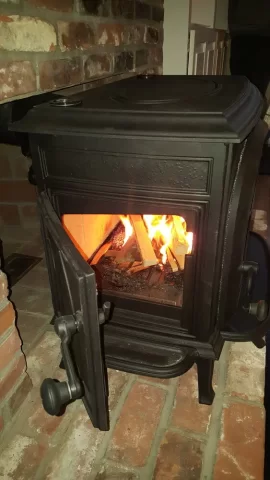

We just had a Jotul F500 V3 installed in November, pretty much same setup into masonry chimney with 27.5 ft draft. We use an Imperial for the Cat temperature gauge (the allen screw comes out and the thermometer goes right in). This is a great way to monitor your combustion temperatures. I also had to do the short leg kit since we are about 1/2 inch under the lentil, it fit perfect.
I have 2 Inferno thermometers on the top of the stove (you can see in the first pic during a break in fire). The top right corner seems to be the hottest location the top left is about average for the rest of the stove so I pretty much average the two. I have a handheld temperature gun and the Infernos are always within 30 degrees.
Our installer did call Jotul and they recommend a double wall or insulated flex in colder areas. We are in Northern CT almost Massachusetts in the hills, so it does get pretty cold up here. The double wall and/or insulated helps with draft and hot flue gases = less creosote. We ended up going with the double wall flex SS/Titanium, we have had no issues and the stove burns well. We have a 3000 sq ft house w/ 9 ft ceilings and I have no problem heating the whole downstairs 70-76 when its 10 degrees or colder. The upstairs will stay around 66-68. When it really gets cold, I will run the stove around 550 and turn the air down to 1/8, the cat and baffle tubes really get going. Hope this helps, enjoy the stove.
