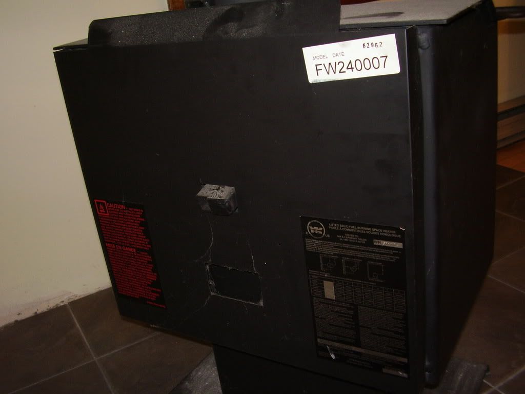

It looks like there is a cap welded over half of that tube. Is yours closed off that way also? I suppose if there was too much air being pulled in, it might give you that run away fire. If that tube is half closed off, try sticking a magnet over or some aluminum foil into the opening to further close it off.

What modification?
What are you measuring your temps with?
On my Century, I added firebrick and kaowool above the secondaries in order to insulate them and force the smoke over them. The original design left some healthy gaps around some firebrick. I think Damian did something similar.
