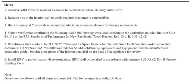

Now that the final inspection is required to operate the stove, the local building department is requiring a Heat Recovery Ventilation (HRV) system to be installed in order to pass inspection.
That they didn't make this clear when the duct work was being done and the wood stove was in the plans has me cheesed, but I get the sense they know as much about wood burning stoves as me (that is to say, not a lot).
What I'd like to find out here is: 1. does anyone have experience bypassing the requirement to install HRV by way of a blower-door test or some other means?
2. Is my house likely to be too leaky in terms of natural ventilation to benefit from mechanical ventilation? There's still over half the surface area of the home that has no insulation.
3. What would you do now if you were in my situation? I'm trying to determine if there's a case to appeal this. And along with this, they've issued an "order to comply" meaning the wood stove would need to be removed if I can't get it to comply within their imposed time frame.
The attached image has the wording of the inspection requirements, and the referenced clause is pasted below:
9.32.3.8. Protection Against Depressurization
(1) When determining the need to provide protection against depressurization, consideration must be given to,
(a) whether the presence of soil gas is deemed to be a problem, and
(b) the presence of solid fuel-fired combustion appliances.
(2) Where a solid fuel-fired combustion appliance is installed, the ventilation system shall include a heat recovery ventilator that is designed to operate so that the flow of exhaust air does not exceed the flow of intake air in any operating mode, and that complies with the requirements of Article 9.32.3.11.
Have at it! And thanks for any thoughts you can share on this issue.

Did you discuss an outside air supply for the stove with the seller, installer or inspector? I would think that would make this point moot. An HRV is not the only solution.
No, I had no discussions with any of them on outside air supply. There was a note on a previous inspection report stating, under notes for proposed wood stove: ". HVAC system requirements shall comply to revised permit conditions." That's it.
I believe this stove is mobile home approved. This type of installation has stricter guidelines, one of which is outside air. With an outside air supply there is no risk of depleting interior air supply. I t supplies the stove with outside air for combustion.
I would call the stove seller first and discuss so that you are well informed with the options. Ask if they have run into this before. Then call the inspector's office if an alternative if feasible and preferable.
Thanks @begreen - I am looking into whether Morso's optional "outside air kit" can be installed to meet the building department's requirements, foregoing the HRV.
On the website www.stovesonline.co.uk I found this info about outside air for my model: "Optional direct air kit available. Primary and Secondary direct, it can be made 100% sealed by simply sealing the heat-shield to the back of the stove around where the air spigot is attached."
Under "Direct Air Supply Type" this model is listed as "TOTAL" for what it's worth.
Wouldn't this achieve the same thing as what the HRV would do, address the risk of depressurization?
Yes. Read the north american manual for more details on connecting.
Erm... that inspector is suspect.
Every HRV/ERV I've looked at specifically says it is NOT to be used for makeup air on solid fuel or other combustion devices.
The mfgs do see comfortable using it for exhausting dryers and possibly small externally exhausting range hoods but even then they are cagey about the CFM.
HRV/ERV is really for tight new construction type stuff anyway.
A mobile home style Outside Air Kit is one solution to make the inspector happy. The other solution is a 'near outside' air source which is nothing more then a dedicated vent that brings outside air in near the inlet for the combustion device. If you have radon then that air will have to come from somewhere outside the home. If not, you could in theory pull that air from a vented crawlspace or basement.
There is some debate about the effectiveness of OAK/near outside air but after 2 years of using an insert as the sole source of heat in a leaky house, having a direct OAK will help a ton. Or you could do what I did before the remodel: get a fresh reload nice and hot then walk around perimiter walls with no socks on... Cheaper then renting a FLIR!
The inspector has some wires crossed here somehow. I doubt you get an HRV manufacturer to state they are designed for supplying combustion air to a stove.

An update on this: only condition left for closing off the permit is the HRV/ERV.
The requirement was added when we applied for a revision to allow a wood stove. (But in fact they didn't have it required in that revision either, acknowledged as an error).
The inspector said that he doesn't have the authority to waive that requirement.
In speaking with an HVAC specialist, he said that HRV would dry the house out more when the Morso is in operation.
And said to make the case to the building department that it is an occasional use unit with effective output of 24000 BTU / hr, which is only half of the geothermal unit's output. As in, it's not a primary heating source.
I don't know, it just seems like if an HVAC guy isn't pushing for it, a WETT certified installer is not pushing for it, and it wasn't in the original requirements for the renovations, then what value is there in adding one for the sake of the wood stove? I'd welcome any thoughts on how best to approach the building department.
This is why people get pizzed. More morons with authority.
Am I misinterpreting, or the inspector? Could you expand on this?
He is misinterpreting. And that would be my interpretation - what I said.
I.e, if you have no ventilation system, it doesn't matter. If you do have one, it needs to incorporate an HRV.
And no, the wood stove would not be the primary heating. If that is a conceived issue with them. It is only to supplement.
EDIT: Do you have a ventilation system now?
Combustion air is for combustion. Does an HRV exhaust as much air as it takes in?
Yes. If the distribution system is properly designed (balanced).
More on my point about the wording above. Imo it's a 2 stage thing it is trying to say. First, if you have a ventilation system, then it needs an HRV. Second, if the first is so, then the HRV must also be balanced to ensure exhaust is not more than intake. Because if it was, it could negatively effect your stove draft.
It is not trying to simply say that if you have a wood stove then you need an HRV. But the code guy is interpreting it that way.
IMO.

I've done as you suggested @maple1 and contacted the Ontario Building Code office. The gentleman there was helpful, in terms of offering an alternative:
Also, instead of Part 9, your designer could make use of Part 6 design which refers to the CSA F326. The CSA F326 includes provisions to get away from the requirement of the HRV .
So I took that info to a friend who is a mechanical engineer working on HVAC projects. He said I might not be able to apply that standard he mentioned, partly because the provision requires a calculation where our vented dryer in the house throws everything off. A better alternative than HRV is a make-up air unit. Anyone have experience with products from Thermolec or Electro?
