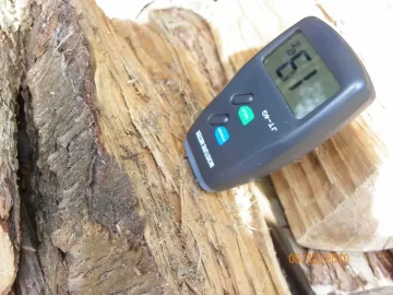

This is the way I use it, I push it in until it stops. I tested some in the summer after being stacked the previous fall then again in the fall but this is cherry which seasons quicker than oak..

Thanks Zap. Mine looks just like yours there but the model number is MD-2G?
I can rarely get it to stick in the wood so it's in as good as you've got it there. I could kinda stick it in with some force with the palm of my hand, kinda "hitting" it into the wood, but I'm worried I'll break the thing.

The cherry it goes into pretty good but the sugar maple and beech is tough so I won't force it, I meant to order the two prong but the four prong is good.
