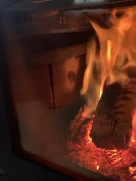

My first break-in fire.
[Hearth.com] How big of a firebox should I upgrade to?
I just bought (on sale, of course) an Englander w06, to replace a Jotul F3 CB, and the amount of heat this thing puts out is rather startling. My oil furnace will be able to take some much needed time off.
Looking good!
