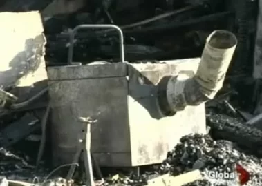

This does not appear to have anything to do with the wind or the wood. Blaming the wind is just looking for another scapegoat for his ignorance. The stove appears to have an 8" flue collar, choked down to 6". with the pipe aluminum taped to what appears to be thin-wall galvanized. Though to be fair it is hard to identify the pipe exactly. I suspect the actual cause was not the wind at all. My guess would be bad clearances. The fact that he set up a home like this with a 16 mo child is scary and reckless. Methinks he needs to spend a less time getting advice from his buddies at Whiskey-Jack's Pub and some real time here at Hearth.com.

Well, the wind likely did contribute. By increasing draft in a leaky old stove and getting the pipe too hot in a shoddy installation, probably even starting a chimney fire. That probably looked like the wind blowing the fire back in.
yes, I'm sure there's more to this story.
