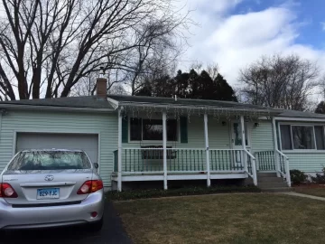

No there was no wind just cold about 7 degrees. That's the weird part. Only thing that could of been running was oil burner but that always kicks on every so often & never had an issue. Right now I am getting a good down draft out of the pipe but the clothes dryer is running & boiler in basement plus bathroom fan upstairs. We have a ranch with partially finished basement.

He has an equivalent vent length of 15 in just the 90 degree bends alone and 9 in the vertical portion he is definately in 4" vent territory and creeping up on the overall limit.
If he has access to the flue at pellet stove exhaust vent level he would be better off entering the flue that way and 90 degrees and then up. That might even put him in 3" territory.
