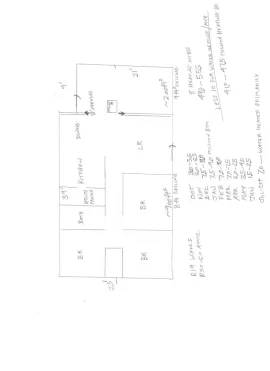

Hello Hearth Members! I recently joined the forum after reading dozens of posts since I hope to become a new wood stove owner/user. I hope to obtain guidance on the sizing for my home. I have a nearby friend with a Woodstock Fireview that primarily burns local spruce in his similarly sized home here in South Central CO at 8000' and loves it. Woodstock stoves look terrific but price and shipping make it rather prohibitive. The nearby Kuma dealer said their Aberdeen would not last the night with spruce. I plan to have a straight 6" double wall flue 18-19' high from the stovetop to account for altitude and a 4" PVC fresh air intake routed to the base. I have attached a sketch of my home with natural gas use by month. The heaviest winter heating is between 6 pm to 10 am as we benefit from a little solar heating, except for the few cloudy days here. I would like to avoid cold starts and reload once a day if possible, hence the BK choice. I have a local dealer with less than knowledgeable staff and being my first stove decided to ask the pros!
My thoughts about the models:
20 Chinook + might be correct output - too small firebox for extended burn times with spruce?
BX24 + has the lowest minimum output, mid-size firebox, best ash drawer? , looks - lacking fresh air input? , smaller splits? , damper hook/tool inconvenience?
30 Chinook + larger firebox, looks - too high output?
PE32 Princess + larger firebox, max output, possibly best value at my dealer - too high output?
