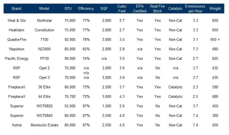

I'm attaching a list I compiles of Zero Clearance FP's. I would stay with the small cubic feet models since you only have 5 feet to work with.

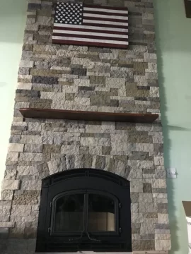

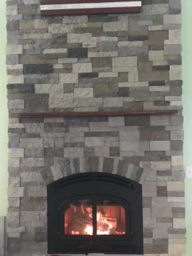

Just installed a Quardra 7100 last week! Unit is pricey but wow is it amazing! So much heat output. Came with the Everytjing for the install minus 6 and 4 inch flex pipe for chimney fresh air and outside air. Have achieved 12 + hour burn times so far! Good Luck

That is one gorgeous fireplace Bgunner! Congrats - nice work!

Thanks Matt!
I did not insulate the 6 inch duct. My run is less than 2 feet and when i framed the "Dog House" it all got insulated with stone insulation and covered in Hardibacker. So I am not concerned with the condesation causing Issues with framing or Mold. Not sure any other reason to insulate. Only Minor issue I am having with my unit is Darkening of the glass. I think my wood is too wet. So keep that in mind with your new unit ZC and hope you love yours as much as I love mine.
