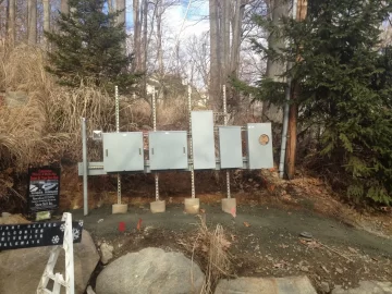

Yes I am very aware, I just like pictures of huge (comparatively speaking) servicesWe actually put in a 400A single phase service 600' from the last pole, pad mount XFMR and all, a couple of weeks ago. Guy insisted he needed 200a for the house and 200a for the shop. Holy overkill batman.

Several houses in my neighborhood have 400A or 600A service, but they all seem to be run as multiple 200A feeds to individual disconnect boxes at the house. Not sure why...As a licences electrician pics of that alone would be great. A 320 amp residential service is scary indeed. S
So true, is see these houses by me install 320amp services, I look them up a year later in our system and see there only using 8kw peak. I've only did one 600amp service for a house >15,000sqft (that's not a typo) I installed a 50kva xfmr for sole use. 600amp services are a pain in the butt, we require a main non-fused disconnect before the customer supplied /installed c.t. cabinet, then we have to wire the (2) c.t's its time consuming when the house will only use 100amps or so at the end of the day.In our area I'd defy anyone to actually use 100A in a residential setting. Unless of course there is significant resistance electric heat. Notice I said significant. In all of my years in the electrical field, I've never seen a main breaker trip due to overloading, on a reasonable balanced load.
I only put in a 100A service in my 3200 ft2 house. I bet I could get away with a 60A main breaker.
