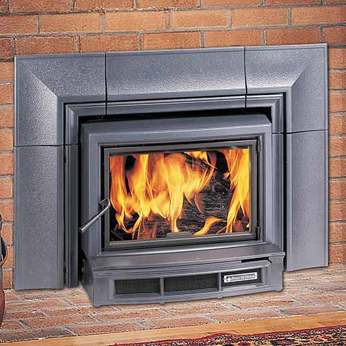

Few things I don’t like really about this particular stove.
First, very little radiant heat so the fan needs to be running constantly, which sucks because we had a pellet stove for the last 6 winters and the fan noise drove my wife nuts, part of the reason we went to wood.
Second, the fan cover is right below the door by maybe 1/4”, so if you open the door and/or load it and some ash/coals fall out, you can’t close the door without scooping it clean first.
Third, the gasket is located on the stove not the door. So when you scoop up the ashes which fall out you’re constantly agitating the gasket. I had to replace it after last year and it’s loose again now.
Last, the burn box is extremely small. To be fair that one I knew beforehand but went off the sq ft rating as opposed to the size.

It doesn't sound like there is anything wrong with the stove, though I agree that I like the gasket to be on the door. Have you tried using RTV to adhere the gasket? Flush inserts will be more dependent on the blower. With dry wood and a block-off plate, the insert will heat much better, but that will not change the 1.7 cu ft firebox size. Sounds like the Clydesdale or larger insert would have been a better fit from the beginning.

I used the gasket adhesive which came with the gasket from the dealer to replace it, not sure if RTV will work better but I’ll give it a shot as this didn’t work.
Most of the stuff we don’t like about the stove has more to do with being annoyed than not working. A bigger one would definitely have been the way to go as now I’m not sure if we want a bigger fireplace or a stove instead.
Rutland now sells black RTV gasket cement, but most black or red RTV will work. Close the door and let it set up for 24 hrs.

Have you seen stoves that use RTV in that instance? It might work on the stove body, but it gets a lot hotter than the door-frame gasket which is shielded by the stove body. That said, I've seen RTV at the auto parts store that's rated for 850 intermittent so it might hold. I've also seen 1000 degree stuff at a stove shop, but it's a specialty item and you have to buy a big caulk tube, I think.

Copper RTV is pretty high temp, 700º I think.

By bigger fireplace I meant an insert with a bigger firebox. This one is only 1.7 cubic feet so difficult to load it up especially for overnight.
I don’t know if it was the cleaning or if we got to a different part of the wood I bought but today we have some serious heat coming out. It’s 72 inside and for the first time this winter my wife said it was warm in our house. The stove temperature is running around 450 and for the moment all is well.

I don’t know if it’s the 8470 and yes the blower is on high.
If it is a 8470, the specs calls for 40,000 btu which sound low if you want to heat 1300s.f.

With dry wood, and dense species with higher BTU if you can get 'em, you'll be able to cut the air lower and your stove will hold an overnight fire better. I only have a 1.4 cu.ft. firebox, and get overnight burns easily unless it's single digits and windy, where this house loses more heat due to poor insulation and some air leaks which I haven't fixed yet. It's a cat stove, though, and it can stretch the burns out longer..
I understand that the guy's offer to let you trade up is tempting, and there are other things about the stove you don't like. It sounds like you are leaning that way. What brands does that shop carry?

EPA numbers say it puts out a little more max heat than my Dutchwest backup stove does, and that stove struggles to keep up here if it gets cold and windy. Milder climate here, but way leakier and under-insulated house compared to what he has.
One of his main desires is for a bigger firebox, but I bet his present stove has a fighting chance with dry, higher-BTU wood, which I think he has in southern ON...Sugar Maple and maybe Oak.
His noisy-blower complaint is another factor. I don't like blower noise either, I have it with the Dutchwest if it's cold and windy out, and I need the blower to keep up. With a bigger box, free-standing stove, no blower needed. An insert would still have a blower, but if he could hear it at the dealer, he'd know if he could handle the noise.

That's where it becomes a balancing act, especially with a non-cat stove which doesn't have the ability to burn at low output like a cat stove would, yet still burn clean. Your only recourse to moderate output is to burn a smaller load, then it's like you are burning a stove with a smaller firebox anyway, and the overnight burn will be about the same.
