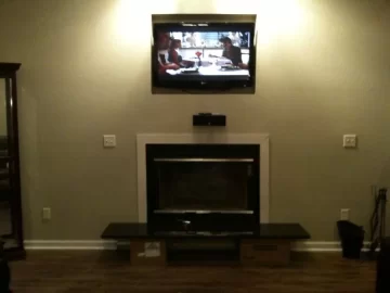

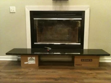

I have searched the manual on the Lopi Republic 1750i and all I can find requirement-wise for the hearth is:
• Must extend 16" in front of the insert and 8" on both sides (min. 26" deep by 40-1/4" wide)
• Must be non-combustible and at least .018" thick (26 gauge)
Size is addressed (min 40 1/4" x 26") but no R value requirements are stated. Next to 26" depth of hearth, it states "This is the distance the insert protrudes from the fireplace opening plus the required 16" of hearth extension."
So, 2 questions:
1. I'm bleeding money all over the place and am running dry, so I need to meet "non-combustible" requirements BUT as inexpensively as possible. Hearth is going to be 10-12" tall. I have a piece of 1" thick granite to use as the hearth top, which I was going to set on top of cement board, but under that does it have to be metal studs and insulated and all? (I don't mean to sound cheap, but seriously, $200 in materials sounds like a fortune right now, plus I've got to pay guys to build it.)
2. My precious piece of free granite is only 15" deep; to get anywhere close to 26" deep, I was going to cut out my laminate floor in front of the hearth and lay down cement board and granite tile. Will that suffice to meet 26" requirement?
Many thanks for everyone's wisdom and patience!!
Karen
