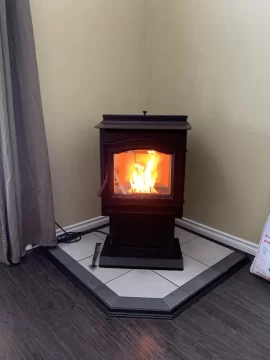

the reason I decided against pellet or NG furnace is because the ducting was quoted to me at 5-7K plus the cost of the furnace so pellet stove was more affordable. NG is also veeeery expensive here and people supplement their NG with pellet heat. I don’t have a NG line to my home so it would be pretty expensive to change into a gas system. I will look into the mini splits I haven’t heard of that! I am getting my pellet stove (P68) installed tomorrow morning though so it will be for educational purposes.
I like the extra insulation idea! I will definitely look into that too. Thanks so much for all the helpful information
