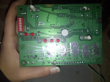

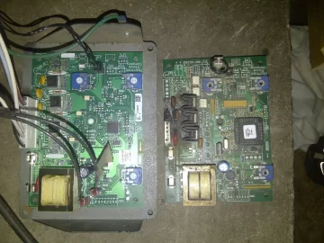

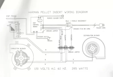

Checked all the outlets in the house and all read at roughly 125 volts. Ordering a new esp probe tonight. All DIP switches are off right now. Stove operates normally except for the auger running constantly when turned on. Haven't actually lit a fire yet because all it does it push pellets out of the pot. Would removing the feeder micro-switch fix the auger running constantly? I appreciate any and all help you guys can give me because I'm up a creek without a paddle and winter is coming.
