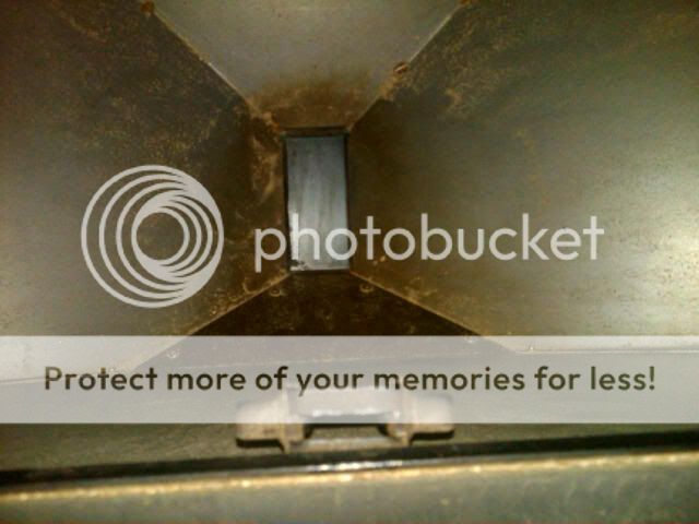

picture of the bottom side of slide plate. there is some build up and it appears to be a potential problem area? intake flapper door is flapping, next ill scope out the esp

esp is pretty gunked up (hard to tell from picture) and here is a photo of the inside of the hopper too

sad to say, Im afraid this is almost certianly the dreaded "gummy stove syndrome". Im betting the residue on the plate is water soluble (put it in a pot of water, leave it for 5 minutes.....I bet the water now has a brownish tinge?)....there is certainly the telltale residue in the hopper as well. Doing the bypass tube thing is fine, but it wont help you with the issue thats already there......you need to clean out all the residue too....means a complete teardown of the unit......4-6 hours if you know what youre doing......
