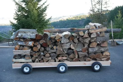

So with the great weather we've been having.... it's not often we in the NW can say that this time of year, and sorry to all you folks back east, I thought I would make a little wood cart and see what effects the recent sun has. I built the cart using the $3. wheels from Harbor Freight, some 5/8" rod, and some scrap plywood. Holds 1/4 cord + as pictured.
Generally our wood doesn't seem to season much this time of year this time of year and the kids accidentally loaded some wood from the "not quite dry" stack. Since the last three days have been clear and dry, (I don't mean to rub that in %-P ) I rolled out my cart of splits that measured between 18-24%. Within 2 hours, the ends facing the sun had dropped between 3-5%. The ends in the shade were still within 1% of their original MC. so I spun the cart around and within an hour that side dropped 3-5%. Now I know the whole piece didn't drop to that level but if the moisture can get out of the ends then the moisture in the middle has a steeper gradient and will dry quicker. Anyway, after 3 days, (about 6 hours each day) MC values average about 13% and I can't get any measurement above 15% and it's easy to see the difference in how they burn in the stove. I just thought it interesting to pass on. My feeling is that the wood heats up in the sun helping to lower the EMC at the wood/air interface as well as adding some energy making it dry faster. At night I roll it into the garage as it's about 30 °F warmer than outside and according to the EMC calculator here: http://www.dpcalc.org/ that drops my EMC from 18.5 to 7.2 which means a whole lot more drying time every day at a lot faster rate.
