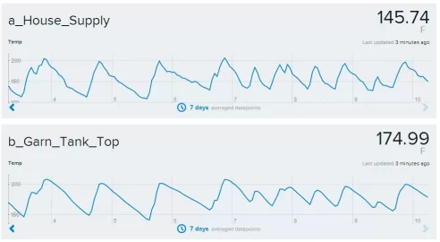

Just thought I would add a plot of my temps over the past week so you can see how we operate our garn. During the winter heating season, we normally burn once a day. But when the polar vortex invades PA, we stepped it up to twice. You can see from the plot below, on 1/4,1/5, and 1/6 we burnt once, and ran from ~200F down to ~150F per day. Then you can see on 1/7, 1/8, and 1/9 we burnt another small load in the morning to boost it up for the day while at work. We most likely would have been o.k. burning only once, I just wanted to be sure I didn't have to play catch-up when I got home from work.

I'm curious Russ, what are the double spikes at peak temps on 1-3, 6, and 7? Did you add more wood at the end of the burn?

Yes, that is exactly what was going on. The house supply sensor, in on the Heat Exchanger side of the pump, so that will show some spikes as the pump turns off and on. But the Tank sensor is in the well next to the Mechanical thermometer. That will always show a smooth plot. Looks like, do to the high demand for heat, and me being lazy, I let the burn drop almost out until I added wood again.
