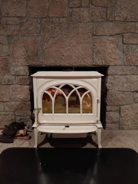

Well everybody, in case anybody still remembers my saga... This is how it ended! An F400 mounted on the hearth.
Love the aesthetics of the stove, just having a few break in fires today/tomorrow before I really see what it can do as a heater.
Thanks to all of you for the help and suggestions. I learned a TON from these forums and you all helped me find an option that truly checks all the boxes for my particular scenario (and most importantly is up to code/safe).
Happy new year! So happy to be back amongst the wood burning brethren after a few years out of the gang!

Looks good, how's it heating?
Looks great! I like it.
TBD. I am still just having 'break-in' fires at this point. Keeping the stove at or below 400 degrees for just an hour or two. The results of those have been encouraging, but I wont know for sure until we get some really cold weather in the Northeast. Its in the high 30's/low 40's here now and these little fires raised the temp in my living room a good 3-4 degrees.
Looks good. Stick around and post your experience so others can learn. Sort of pay it forward. Always good to have difference thoughts from around the US with different set ups. Happy New Year.
Hey Spudman, I definitely plan to stick around and check the forums now and then and weigh-in if any questions of relevance come about. Least I can do! The F400 is thus far heating my house extremely well. The outside temp is still relatively mild for this time of year (high 20's at night and low 40's during the day) but my house is in the mid 70's with the air intake basically as low as it can be. I did open it up the other night and let the stove hit 500 degrees for 2-3 hours and my house was in the high 70's!! It was T-shirt time lol! We'll see how it goes when we get a proper cold snap. Now my issue is the dryness of the air. I have on of these going full-bore in the living room, but it is being completely outclassed by the jotul...
