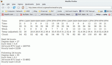

For those who are into this to an obsessive degree, here's a screen shoy of a page that I built to help plan fires. It automatically fetches NOAA forecast data (temp, wind, and cloud cover) in three hour increments for the next 48 hours.
It then applies a wind chill correction based on an analysis of my history - it adds a degree day for every 5 mph of wind speed. Degree days are based on 60 degrees, not 65.
Then, it averages the degree days for the next two 24 hour periods and calculates the heat load. My heat load is a constant 45000 BTU per day (DHW), and a variable amount based on degree days. The formula is:
Heat load = degree days * 8900 + 45000
Then, it calculates the burn time required based on 52,000 BTU/hr - a fair estimate of the EKO 25 average over the course of a fire.

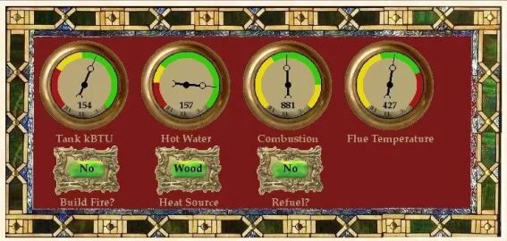

Eventually I'll have it take into account the heat left in storage, and I'll integrate it with my control panel (picture below).

i like the sweeping gauges and such in the second pic.
i could picture that in my kitchen using a LCD computer flat screen. or mounted on the wall somewhere..

Look very cool. I like the interface with the dials and stained glass. How are you making those dials?
For the indicator that tells you whether or not you need to make a fire, do you think you could make it say how soon you need to make a fire? Typically people are going to be faced with a decision like the one I need to make right now... I need to leave for work in an hour and I need to decide whether to make a fire now, or when I get home. If the indicator said I need to make a fire within 5 hours then I know I need to do one before work, but if it says within 10 hours then I know I can wait until after work.

2) This is all accomplished using PHP scripts running on my main server. It queries the system controller to get current temperature data for the boiler and storage, and queries NOAA to get forecast data.
3) The stained glass and brass dials are courtesy of my daughter, who is a graphic artist. I asked for a Victorian era look and she obliged. As mentioned above, it's driven by a PHP script.

Quite seriously, one of the nice things about the NoFossil Control System is the ability to check system status from anywhere. I don't have an iPhone, but I'll bet that it will do a fine job of displaying the simple status web page.
