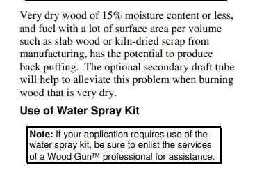

because many have not updated their system to be able to handle drier wood.
See, from the pdf you posted:
[Hearth.com] Firewood moisture content debate for EPA FURNACE
This begs the question of why one would make a water spray system to be able to burn better fuel rather than add such a secondary air system to be able to burn that better fuel without wasting BTUs in pumping out the water.
This vendor apparently does have a secondary air option. I.e. the technology exists (not surprisingly). Hence I'm slackjawed by the "add a water spray or use crappy fuel" advice.
Did you notice that the spray system was for burning sawdust? Might be other issues beyond "its just too dry"...
that is not how I read it. It was *also* for sawdust.
Very dry wood -> back puffing (b/c gasification too fast) -> Sawdust less of a problem than ... logs (!).
Secondary air option. But "In rare cases it may be necessary to add moisture to the fuel".
To me that does not indicate the spray is only for sawdust. Very dry logs are a bigger problem. Secondary air helps. But in (rare) cases water spray may be needed.
The first line...
"A water spray kit is available for all commercial
Wood Gun systems and is normally
recommended if you are burning kiln dried
sawdust or shavings"
